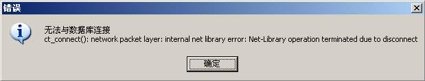

LOAD 数据库完成,不过有提示
Backup Server: 4.58.1.1: Database fydb: 18392776 kilobytes LOADed.
Backup Server: 4.58.1.1: Database fydb: 18599356 kilobytes LOADed.
Backup Server: 4.58.1.1: Database fydb: 18781142 kilobytes LOADed.
Backup Server: 3.42.1.1: LOAD is complete (database fydb).
Caution: You have set up this database to include space on disk 6 for both data
and the transaction log. This can make recovery impossible if that disk fails.
Caution: You have set up this database to include space on disk 7 for both data
All dumped pages have been loaded. SQL Server is now clearing pages above page
9388032, which were not present in the database just loaded.
SQL Server has finished clearing database pages.
Use the ONLINE DATABASE command to bring this database online; SQL Server will
not bring it online automatically.
然后再
online database fydb
没有问题,online成功.....
用dsedit测试服务器,ping 通过,没有问题
可是客户端连到服务器上就是不好,
说是无法与数据连接,这是为什么,大侠帮帮忙......

客户端没有配置好。把客户端的sql.ini和服务端的sql,ini贴出来
