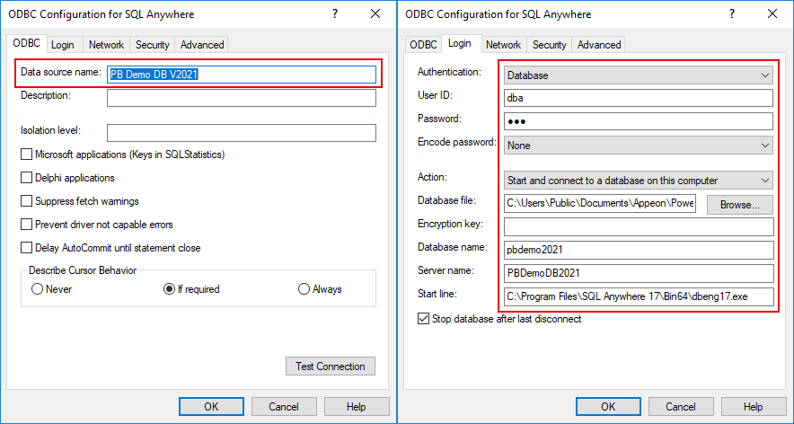

To set up the ODBC data source with the SQL Anywhere demo database,
  • Install SQL Anywhere 17.
  • Create the ODBC data source that includes the following settings.
    Data Source Name: PB Demo DB V2021
    User ID: dba
    Password: sql
    Action: Start and connect to a database on this computer
    Database file: [path to the database file]
    Database name: pbdemo2021
    Server name: PBDemoDB2021
    Start line: [path to the SQL Anywhere engine]

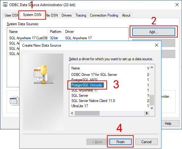

To set up the ODBC data source with the PostgreSQL demo database,
  • Install PostgreSQL 12 and PostgreSQL ODBC driver (32-bit).
    Make sure the Command Line Tools component is selected during the PostgreSQL 12 installation.
  • Restore the PostgreSQL demo database file. For example,
    "C:\Program Files\PostgreSQL\12\bin\pg_restore" --host=127.0.0.1 --port=5432 --username="postgres" --clean --if-exists --dbname=PBDemo --verbose "C:\DB\pbpostgres2021.dmp"

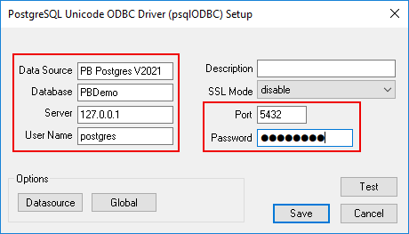

    Data Source: PB Postgres V2021
    Database: PBDemo
    Server: [IP address for the database]
    Username: [user name for the database, postgres, by default]
    Port: [port number for the database, 5432, by default]
    Password: [password for the database, postgres, for example]
